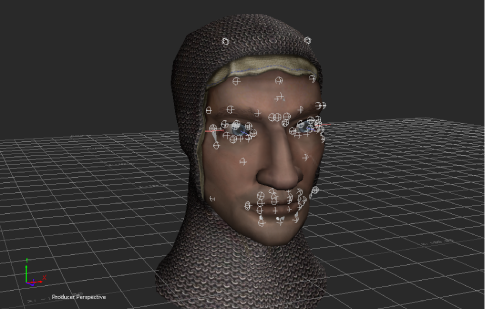

  1. Load a head model with clusters into the scene.
    Head model with cluster shapes

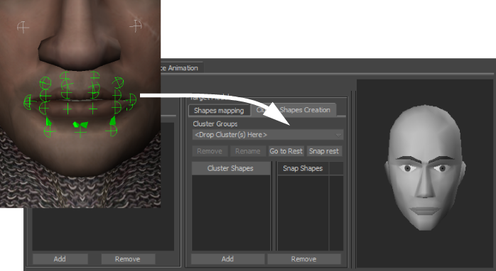

  2. Create cluster groups by doing the following:
    • Select any number of unused clusters, such as all the clusters for the mouth.
    • Alt-drag the selected clusters into the Cluster Groups menu of the Cluster Shapes Creation pane, as shown in the following figure.

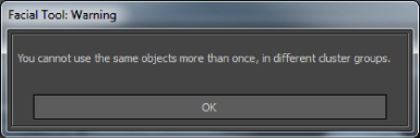

      A cluster group is created. If you attempt to create a cluster group with a cluster already added to another cluster group, a dialog box appears. Each cluster can only belong to one cluster group.
      Facial Tool: Warning dialog box
