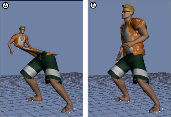

Local blending is a special method of blending takes. It creates blends by replacing the motion plotted to part of a hierarchy in one take with motion from another take. Local blending lets you blend part of the body, such as an arm or the torso, with the rest of the body.
A. Local Blending option disabled B. Local Blending option activated
For example, the previous figure shows a character before and after the Local Blending option is active. One cut animates the character’s lower body, while another cut animates the character’s upper body. When the Local Blending option is disabled, the animation of the upper body and the lower body do not blend properly. When the Local Blending option is active, the animation blends without distorting the character.
All the takes you use during a Local blend must contain motion data plotted to the same skeleton. For best results, the take in the Current Take field should be the same as the take in the Result track’s Take menu. You should select a stabilizing object for your local blend if the blending object is made up of the bones or nodes of a character’s leg.
Local blending can occur only when the Local Blending option is active.
