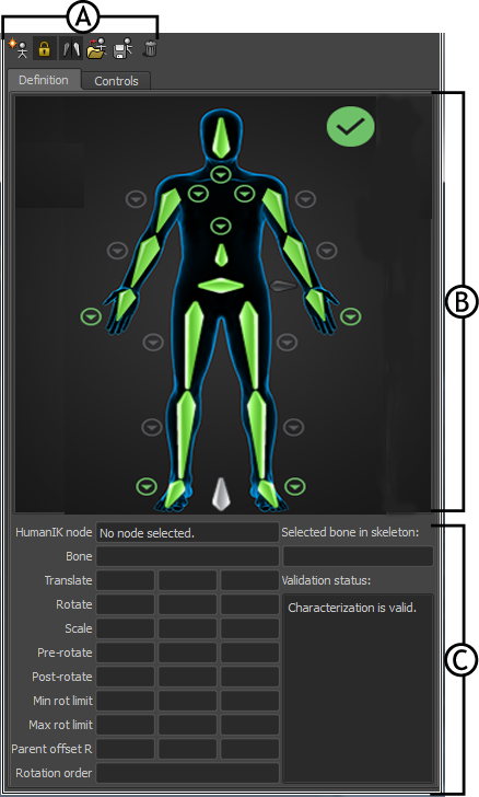

Definition tab
This tab provides a visual interface for mapping the structure of a skeleton. This process results in a HumanIK Skeleton Definition, which is required to create a Control Rig and/or retarget animation to and from the skeleton of a character. This character is referred to as a HumanIK defined character.
Definition tab A. Toolbar B. Character and Name Match views C. Skeleton properties
To create a skeleton definition, click .
To map a bone, navigate from the:
  • Definition tab to your skeleton: Double-click a cell in the Character view (cells turn blue when picked), then click the corresponding bone in the scene.
    or
  • Skeleton to the Definition tab: Select a bone, right-click the corresponding cell in the Character view, and select Assign Selected Bone. Bones in the Figure view turn green to indicate each valid bone assignment.
    For more information on which bones map to which nodes, see HIK character structure.
