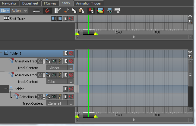

Before you begin recording, you need to set the recording path for your Story Folders and Tracks. The recording path needs to be defined for each track you want to record with the exception of tracks within a Folder. For example, you can set a path for a Folder in the Story window and have the Tracks within that Folder point to the same path. You can also set a path for a Folder in the Story window and another path for the Tracks within that Folder. This applies also to nested Folders and Tracks. Complete lower-level paths overwrite higher-level paths, while a hierarchy of incomplete paths is assembled to form a complete path. This enables you to specify only the subfolder in the track, while the folder contains the base path..

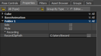

To set a recording path for a Story Folder:
In the Story window, double-click a Folder to display its properties in the Resources window.
Story Folder shown selected
The Story Folders, unlike the Story Tracks, do not have a Recording options (
) and Recording Options menu (
) that enable you to define the recording path.In the Resources window, in the Properties, expand the selected Folder to display its contents.
The recording paths for all Story Folders are set via the Property Resources window.
Click
.In the Open Directory window choose a path for recording and then click OK.
The recording path is set and is now shown in the RecordClipPath field.
To set a recording path for a Story Track:
You can set a Track's recording path via the Property Resources window (as you would for the Story Folders) or via the Story Track's Recording options (
) or Recording Options menu (
) in the Story window.
In the Story window, click the Story Track you want to record.

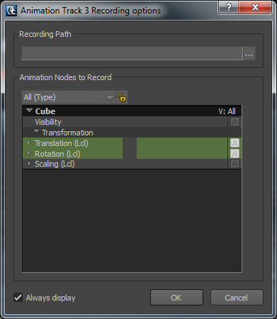

In the Story window, click the Story Track's Recording options (
), or Recording Options menu (
) followed by the Recording options menu
.The selected Track's Recording options window displays.
The properties shown in the Track's Recording option dialog are the properties that can be animated and therefore recorded.
The default activated (
) recording properties shown in the preceding figure are the Translation and Rotation propertiesActivate the properties you wish to record.
Click
Tip:You can also set the recording path by entering the path in the Recording Path field and clicking OK.
