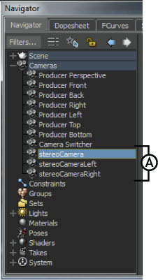

Once you add Stereo camera to a scene, three cameras are listed below the Camera switcher in the Cameras folder. See Creating a stereo camera.
Scene browser A. Stereo cameras
