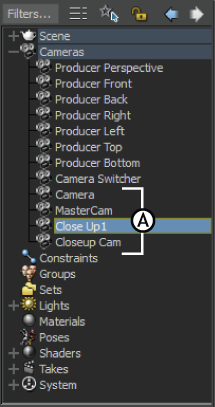

You can add an unlimited amount of cameras, by dragging a camera asset into the Viewer window. These Custom cameras can be manipulated, constrained and animated; they let you alter the settings to mimic real-world camera and film aspects. Once you add Custom cameras to a scene, they are listed below the Camera switcher in the Cameras folder.
Scene browser A. Custom cameras
