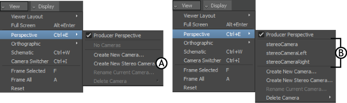

To add a Stereo camera using the Viewer window:
  1. In the Viewer window, click View.
  2. From the View menu select Perspective > Create New Stereo Camera.
  3. The stereoCamera, stereoCameraLeft, and stereoCameraRight cameras are added to the Perspective menu and the Scene browser's list of camera's beneath the Camera switcher.
    View menu A. Add a stereo camera B. Stereo cameras in the Perspective menu

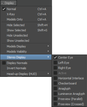

To adjust the Stereo camera viewing modes:
  1. In the Viewer window, click Display.
  2. From the Display menu select Stereo Display.
    Note:
    The Stereo Display menu item will remain disabled until you are looking through the stereo camera in your scene.
    Stereo Display menu
  3. The Stereo Display menu lets you select from different viewing modes.
