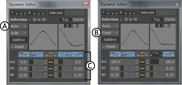

In the Dynamic Editor, select Auto in the Interpolation Mode menu.
The selected animation has Auto interpolation, and the Auto interpolation settings display in the settings area.
Dynamic Editor A. Interpolation Mode menu B. Interpolation Options menu C. Interpolation settings
In the Interpolation Options menu, select either Auto or Fixed. Auto is the default.
