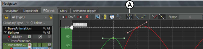

To change the interpolation of a keyframe to Auto:
In the FCurves window, select the keyframe or keyframes whose interpolation you want to change.
In the Tangent options, select Auto to set the interpolation type.
FCurves window (detail) A. Auto interpolation type selected for the Translation keyframes

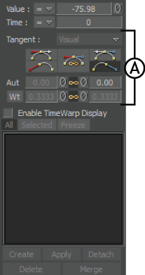

Edit the interpolation by dragging each tangent handle, or by using the settings in the Tangent area. These settings let you change the behavior, angle, and weight of tangents. See Tangent area.
FCurves window A. Tangent area settings
