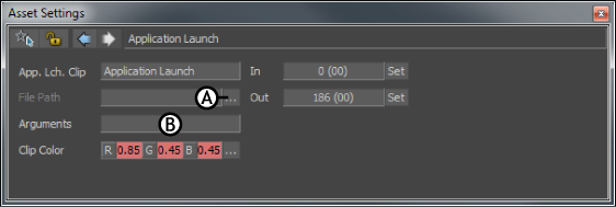

To create an Application Launch command clip:
Double-click the Application Launch clip to select it.
The clip’s settings display in the Asset Settings window.
Click the browse button of the File Path setting, select the application you want to launch.
Asset Settings window A. Browse button of the File Path settings. B. Arguments field.
Type arguments in the Arguments field, if necessary.
