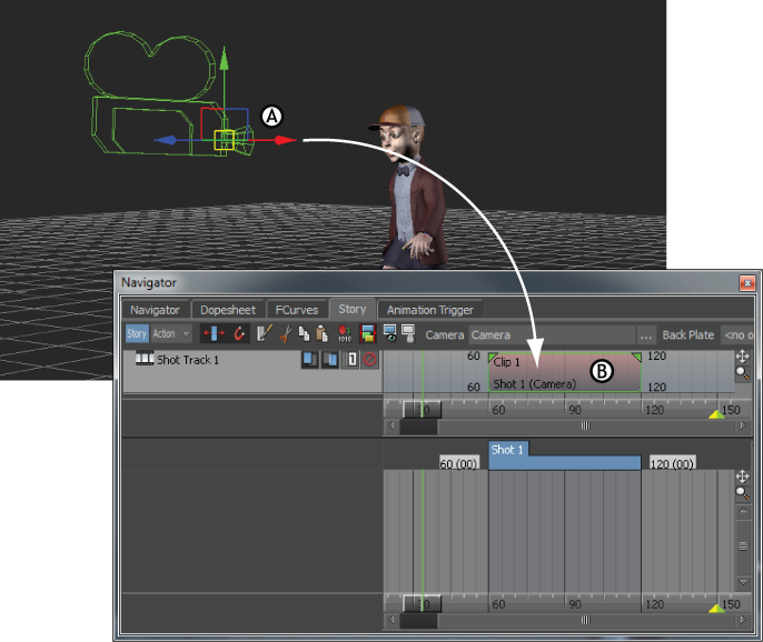

Add and position cameras in your scene.
Alt-drag cameras from the Viewer window or Scene browser into the Edit Track.
Note:You can use one camera to create multiple shots, or use different cameras for each shot.
A Shot track appears, and a shot clip is created for each camera you drag onto the Edit track.
Shot clip A. Custom camera in the Viewer window B. Shot clip created after dropping the Custom camera into a Shot track

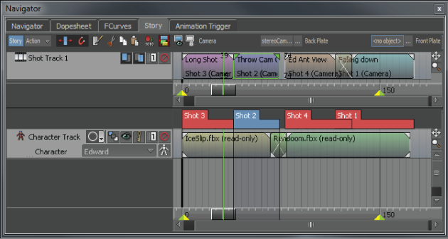

Do any of the following to the shot clips on the Edit track:
Drag the clips along the Edit track to arrange them.
Stretch the beginning or end of clips to increase or decrease the duration of the camera shot.
Overlap the clips to create a cross fade effect.
Note:To overlap the clips, switch the Story window into Edit mode.
Three cameras arranged into four shot clips on the Edit track
In the preceding figure, the first and third camera shots are the same, only the shot clips are renamed.
