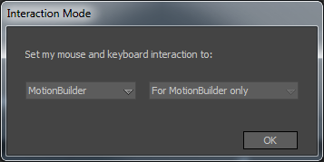

Interaction Mode
The Interaction Mode lets you to quickly choose the keyboard shortcut set to use within MotionBuilder, and for all products within the Suite if applicable. By default, the interaction mode is set to the product currently launched.
When you first launch MotionBuilder, the Interaction Mode window displays, enabling you to specify a keyboard set.
The options available depend on the software installed on your system and on whether the software installed on your system is part of a Suite license software product. For example, if you installed Maya as part of a Suite software product and are running the product using a suite license, you can also set whether you want to use the same set of keyboard shortcuts across all the products in your suite.

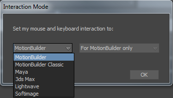

For example, if you are using the Autodesk Maya software product and the MotionBuilder software product for your project, if you are not familiar with the MotionBuilder keyboard shortcuts or prefer to use the Maya keyboard shortcuts while working in the MotionBuilder software, you can change the keyboard shortcut configuration in MotionBuilder to use the Maya keyboard shortcuts.
MotionBuilder has two sets of keyboard shortcuts (i.e. MotionBuilder and MotionBuilder Classic) as well as four sets of keyboard configurations that simulate the keyboard shortcuts from other popular 3D software applications.

Launch MotionBuilder.
The Interaction Mode window displays.
Choose the interaction mode from the list of supported keyboard shortcut sets.
Click OK.
To subsequently change the interaction mode:
- From the menu bar, select Settings
Interaction Mode. - Choose the interaction mode from the list of supported keyboard shortcut sets.
