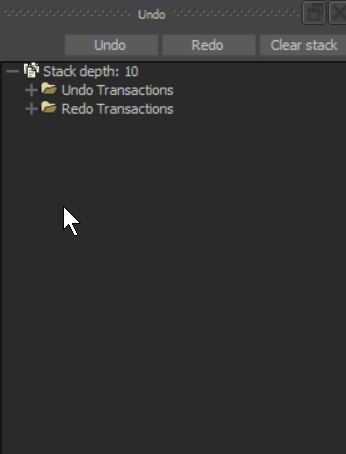

Undo
Opens the Undo window, letting you see the current undo and redo stack information, such as the current undo stack depth (undo level), the elements in the undo and redo stacks, and buttons to interact or manage the stacks.
You can change the level of undos or redos in the undo stack in the Undo Preferences.
