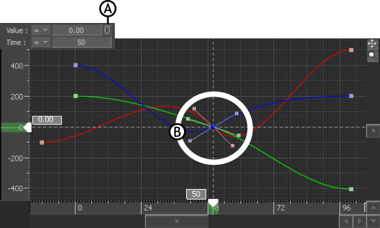

The Value and Time settings (A and B in the following figure) let you edit keyframes by adding, subtracting, or multiplying by a specific value or time for offsetting keyframe selections without changing the animation.
A. Value settings B. Time settings
- Value — Reflects the value of a selected keyframe in the FCurves pane. The Value menu allows you to edit keyframes by a selected value.
- Time — Reflects the time of a selected keyframe in the FCurves pane. The Time menu allows you to edit keyframes by a selected time.

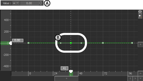

In the following figure, the equals (=) option is selected and 0 (zero) is in the value field. This causes the selected keyframe to appear flat, as shown in the following figure.
A. Value field reflects the selected value of curve B. Selected keyframe in the FCurves pane

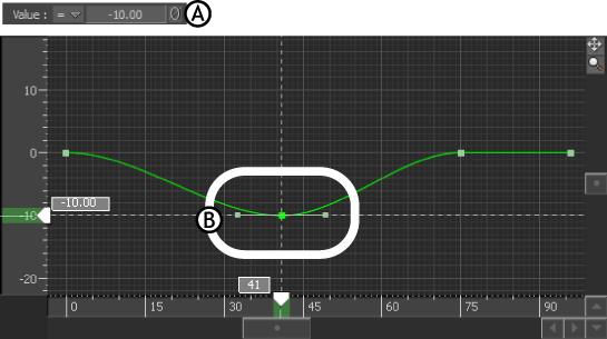

In the following figure, the minus (-) option is selected and 10 is in the Value field. This causes the selected keyframe to make a negative shift from 0 to -10.
A. Negative value shown as a result of selecting “-” as the Value option B. The Selected keyframe changes to the selected value in the FCurves pane
