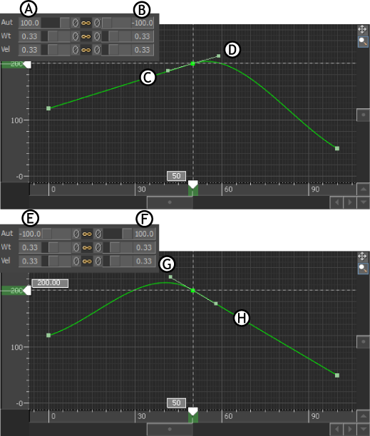

Auto settings A. Value for left tangent B. Reset left tangent C. Link option D. Reset right tangent E. Value for right tangent

Editing tangent angles using Auto settings A. Left Auto field is set to 100 B. Right Auto field is set to -100 C. Left tangent points to the previous keyframe D. Right tangent points away from the previous keyframe E. Left Auto field is set to -100. F. Right Auto field is set to 100 G. Left tangent points away from the next keyframe H. Right tangent points to the next keyframe

| 0 | At 0, the curve represents the average between the previous and next keyframes. |
| 100 | When the left Auto field is at 100, the left tangent points to the previous keyframe (A and C in the figure above). When the right Auto field is at 100, the right tangent points to the next keyframe (F and H in the figure above). |
| -100 | When the left Auto field is at -100, the left tangent points away from the next keyframe (E and G in the figure above).When the right Auto field is at -100, the right tangent points away from the previous keyframe (B and D in the figure above). |
