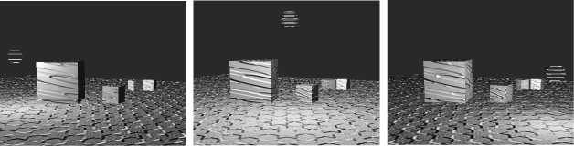

Normal Map effect
You can also use the Dynamic Lighting shader to read relief from Normal maps.
Use the Dynamic Lighting shader to create Normal map effects
