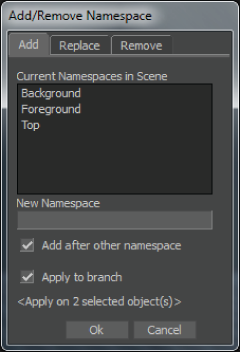

The Add/Remove Namespace dialog box appears, displaying in numeric alpha order the namespaces in the scene.
Add/Remove Namespace dialog box displaying namespaces in scene

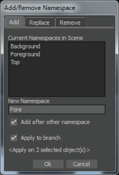

Click the “Add” tab.
To add a namespace after a prefix, Activate the “Add after other namespace” option.
Enter characters in the “New Namespace” field.
Add/Remove Namespace dialog box displaying namespaces to prepend to branch
Ensure the following options are enabled:
When this option is enabled, the name entered in the “New Namespace” field is prepended to the current namespace(s).
Apply to branch
When this option is enabled, the name entered in the “New Namespace” field is prepended to the whole branch.
Note:To change only the first occurrence of the prefix, leave the Apply to branch option disabled.
Prepending namespaces to objects or branches may affect the merge-back of the animation as this process is based on the names of objects and branches.
Click OK.
The namespace is applied throughout the selected object’s hierarchy as shown in the following figure.
