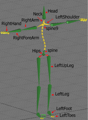

  1. Create a skeleton in 3ds Max. Refer to the following example.
>Tip: Use the Left or Right view to create your bone skeleton as it is easier to view the position of the bone objects as you create, move and rotate the objects.
![](../images/skeleton.png)
3ds Max Hierarchy example
The green bones represent bones that must be dropped into the base slots of the Define pane in the Character Tool in MotionBuilder.

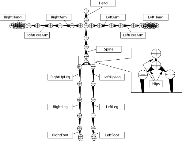

  1. Build the skeleton using a standard hierarchy such as the one shown in the following diagram.
![](../images/skeleton_naming.png)
Skeleton hierarchy

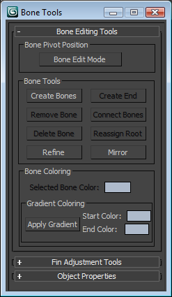

  1. From the 3ds Max menu bar, select Animation > Bone Tools.
![](../images/3dsMax_w_BoneTools.png)
>Note: Bones are considered Geometry, which lets you use Scale and Squash channels. However, these channels are not supported in MotionBuilder.
