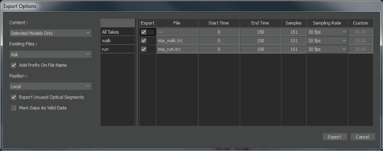

Exporting options for scenes
Depending on the scene you are exporting, other dialog boxes may appear, prompting you to enter additional information.
Use the file browser to choose a location and give the scene a descriptive file name. Make sure you save your scene with the proper extension. Otherwise, you may not be able to load your exported scene into other software packages.
Click OK to export your scene using the selected scene format. The Export Options dialog box appears, letting you select which parts of the scene you want to export.
Exporting options when exporting scenes
Depending on the scene format you are exporting, there may be limits to what can be exported.
