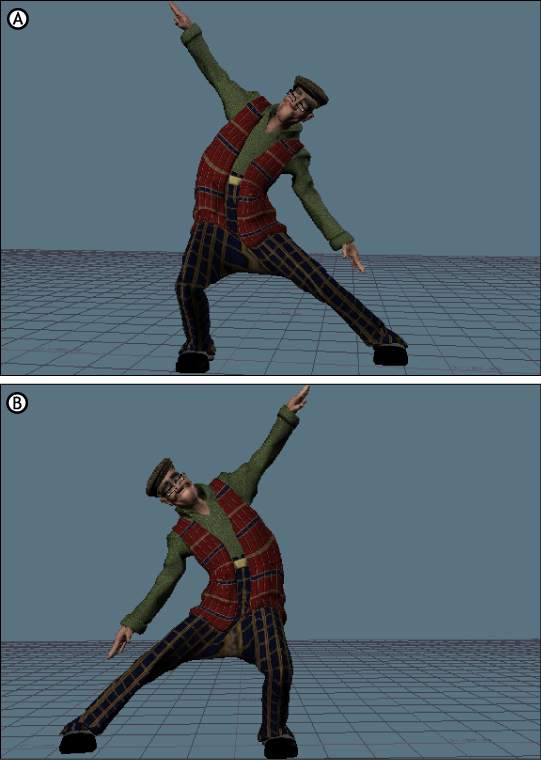

Pasting a Full Body pose with Mirror active A. Original pose B. After pasting

You can mirror full body poses, or you can mirror selected body parts. To mirror a pose on a character’s whole body, select Full Body as the Keying Mode in the Character Controls window and activate the Mirror option. When both are active, pasting mirrors the whole body pose onto the selected character.
To mirror a pose on a character’s selected body part, select Body Parts as the Keying Mode in the Character Controls window and activate the Mirror option. When both of these options are active, pasting a pose mirrors only on the selected body part, so you can paste finger or hand positions from one arm to another, for example.
