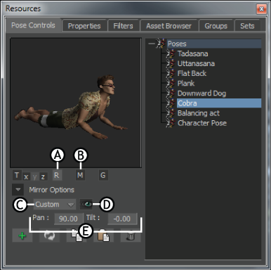

Mirror Plane options A. Rotation is disabled B. Mirror is active C. Mirror mode menu D. Mirror Plane visibility option E. Pan and Tilt values

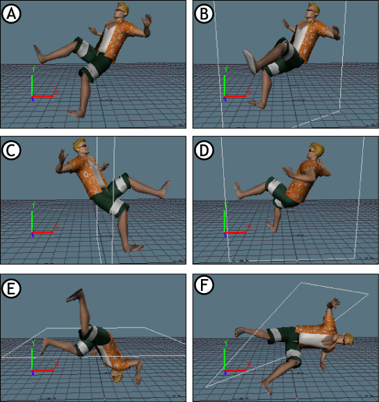

To mirror a pose on the whole body of the current character, select Full Body as the Keying Mode in the Character Controls window and activate Mirror in the Mirror Plane options in the Pose Controls. When both are active, pasting mirrors the full body pose onto the selected character.
For example, the following figure shows the effects of pasting a full body pose onto a character when the various mirror plane modes are active. The pose in the following figure A is the original pose. The right side of the character is mirrored onto the left side, and the orientation of the character changes as each mirror plane mode is used.
Mirror Plane Mode Menu
When the Mirror option in the Match options is activated, and the Rotation (R) option is disabled, you can use the Mirror Plane Mode menu to select the plane on which you want poses to be mirrored.
Mirror Mode menu options A. Original pose B. Auto Mirror mode C. Z-Y plane D. X-Y plane E. X-Z plane F. Custom plane, with Pan and Tilt values of 50

Pan
When Custom is selected in the Mirror Plane Mode menu, you can set the Pan value to rotate the Mirror plane around the global Y-axis.
Tilt
When Custom is selected as the Mirror Plane mode, you can set the Tilt value to rotate the Mirror plane around the global X-axis.
The Pan and Tilt fields are only available if the Custom option is selected in the Mirror Plane Mode menu.

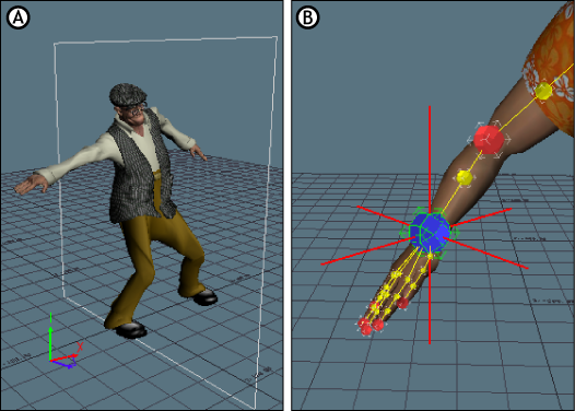

Mirror Visibility
When the Mirror option is active, you can activate and disable the Mirror Visibility option to show or hide the 3D mirror plane you have selected in the Mirror Plane Mode menu. When Rotation is active, the Mirror Visibility option shows or hides the red indicator that displays on the selected object to be matched.
Mirror visibility A. Mirror plane displays for a pose on the Z-Y plane B. Red indicator displays on the right wrist effector to be matched
