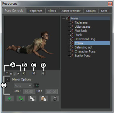

The Match options determine how a selected pose is pasted on the current character or object.
Match options A. Translation B. Rotation C. Mirror D. Gravity E. Mirror Plane options
You can match a pose to the location of the current character based on IK and FK Control rig effectors, Auxiliary effectors and pivots, or any object included in a Character Extension.
