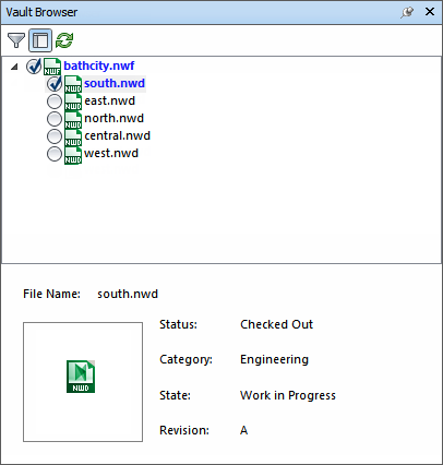

The Vault Browser dockable window enables you to view and manage the vault status of the opened Navisworks files. This is particularly useful when working with NWF files.
The Vault Browser shows the structure and the status of the file currently opened in Navisworks together with its related design files. You can filter the files displayed in the Vault Browser to focus on the data most relevant to your job. You can also use the context menu to perform basic vault related operations, such as check in, check out, and change state.
Files could be checked out to other team members or the version in the vault could be more recent than the version on which you are about to work. You can refresh the Vault Browser as needed to view up-to-date information.
File View
The File View shows the file structure of the file currently opened in Navisworks.
Detail Panel
By default, the Detail panel displays the key information for the file selected in the File View. This key information includes: file name, thumbnail, vault status, category, lifecycle state, and revision. The revision, lifecycle, and categories data is not available if you are using the Autodesk Vault Basic edition.
