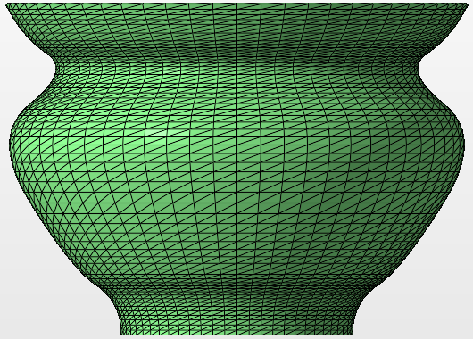

To reduce the number of triangles
Rebuild an existing shape using larger triangles and a tolerated deviation from the original.
Reducing the number of files helps to reduce the file size and speed up the workflow. The more triangles used to make up the mesh, the longer it takes to load and process it.
