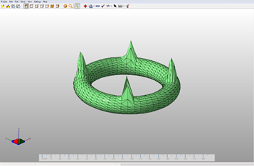

To distort vertices
Move individual triangle nodes with the mouse
Adjust the positioning of vertices on the mesh to distort the part.
  1. Select the part.
  2. Click Modify > Manipulate Mesh.
  3. Click Distort vertices.
  4. Click and drag a vertex on the part to distort the nearby vertices and therefore, the surface of the part.
This command makes use of the brush controls.
A command to move individual nodes with more control is one of the manual tools in repair, Move Node. Read To move a node to learn more about this command.
