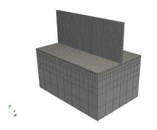

A simulation of a laser powder bed fusion build of a generic geometry from Inconel 625 on a SAE 304 build plate is completed using generic processing conditions, then the heat treatment of the component is modeled using two different heat treatment cycles. The substrate or build plate is assumed to be 25 mm thick. The resulting mesh is illustrated in Figure 1.
Figure 1: Autogenerated mesh
