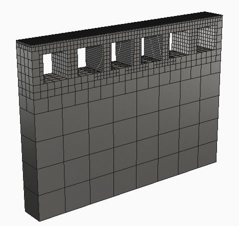

The *PBSS card constrains the sides of the small substrate in the analysis, mimicking the effect of being attached to the larger build plate. The build plate has an initial temperature of 100o C, which is modeled using *INIT. The resulting mesh is illustrated in Figure 1.
Figure 1: Auto-generated finite element mesh
