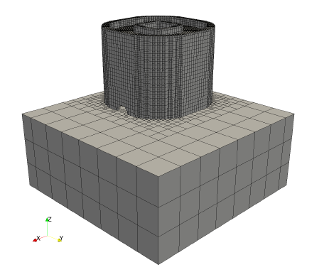

For this example showcasing some advanced part scale modeling option, a sample geometry simulates the powder bed construction of an Inconel 625 part. The layer height is 0.04 mm. The part geometry is imported in the analysis through an STL file, and it is automatically meshed within Local Simulation. The build plate is modeled to be 25 mm thick and 60 mm x 60 mm in area as defined in the *SBDM option. The substrate is fixed to a circular rod defined using the *FIXC card. A controlled temperature of 200o C is applied to the build plate using *PBSH. The resulting mesh is illustrated in Figure 1.
Figure 1: Finite element mesh
