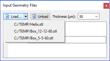

Load files via dialog, or choose a recent file from the dropdown menu:

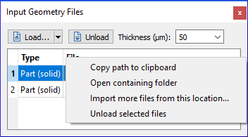

Once loaded, use a file's context menu for additional tasks:

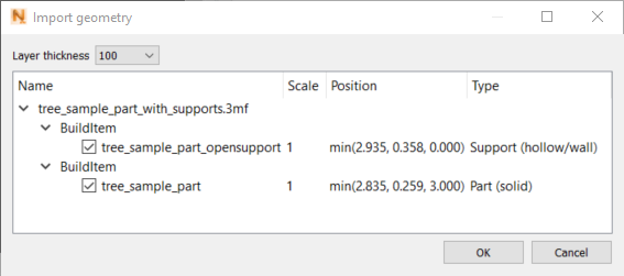

A file may contain more than one object.
For example, when loading a 3MF file, you may import the meshes for part and support geometry from one file.
For each item in the file you can configure attributes:
- Scale: Scaling the object with given factor (1 will keep original size)
- Position: Change the position of the object in x, y, and z by translation with given values:
- Type: Select the geometry type from
- part: Solid part. The imported mesh encloses a volume of solid material
- support: Solid support. The imported mesh encloses a volume of solid material, which is supporting the part.
- hollow part: Thin wall part with no volume
- hollow support: Thin wall support with no volume.
Hollow objects do not define a volume. So, the imported mesh is defining an object of zero thickness. In general this is only useful for supports.
