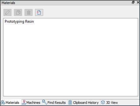

Material definitions are only used within the Advanced Toolpath Utility. Buildstyles refer to these simple string values, which can be added, modified and deleted within the Materials window. Exporting a test build requires selecting a material. Depending on the buildstyle implementation, the material gets evaluated and changes the test build’s output.
