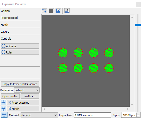

The Exposure Preview is used to inspect the layer data resulting from the selected input geometry files and the toolpath data which is calculated by the buildstyle script based on these input geometries.
The graphic view shows the current layer. The slider on the right navigates through the layers. The coordinate system is X (right), Y (up) and Z (pointing out of the screen).

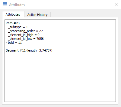

Attribute info
There are path attributes as well as segment attributes for individual segments of the path. Attributes can be internally assigned by the buildstyle processor. Other attributes can be originated in the script code of the buildstyle project where it is possible to declare and assign custom attributes.

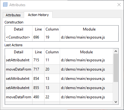

On a second dialog tab the dialog is showing an action history for the selected element. There the user can see the script code line at which the element is created as well as other script code lines where the element has been modified. Double clicking an entry here opens the script code line in an editor window.
View settings
On the left side the view settings are categorized in Original, Preprocessed, Hatch, Layers, Controls. Clicking on one category opens it while closing all others.

Further functions
| Copy to layer stacks viewer | Copies the current layer stack from the preview to the layer stacks viewer control as a snapshot |
| Parameter | A parameter profile can be selected which is used to calculate the preview data. Open Profile shows a dialog to edit the selected parameter profile. Profiles opens the profile manager. |
| Preprocessing | You can trigger the preprocessing script calculation manually. Automatic update can be toggled with the button on the left side. |
| Hatch | The hatching script calculation can be triggered manually. Automatic update can be toggled with the button on the left side. |
| Material | A material can be selected for the hatch preview calculation. This selected material is given to the script function as the current material. The materials available here must be specified within the script function declareMachine. |
| Layer Time | The time for building the current preview layer is shown here. This is the time the machine is expected to use for this layer. This estimation is generated by the buildstyle script. |
| Z-pos | Shows the current Z position of the preview layer. |
