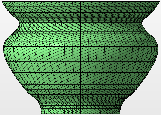

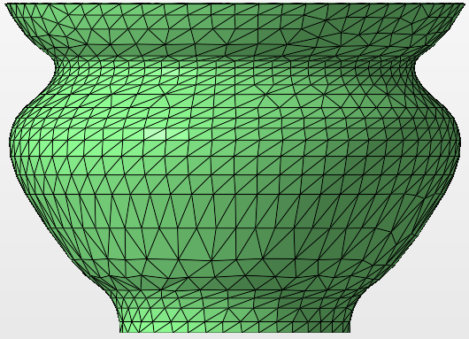

Rebuild an existing shape using larger triangles and a tolerated deviation from the original.
Reducing the number of files helps to reduce the file size and speed up the workflow. The more triangles used to make up the mesh, the longer it takes to load and process it.

- Click Calculate to produce a preview of the new mesh.
- Click OK to apply the triangle reduction.

- Click and hold Show Original Mesh to see original mesh before the triangle reduction.
