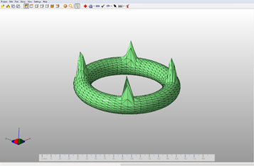

Move individual triangle nodes with the mouse
Adjust the positioning of vertices on the mesh to distort the part.
- Select the part.
- Click .
- Click
Distort vertices.
- Click and drag a vertex on the part to distort the nearby vertices and therefore, the surface of the part.
This command makes use of the brush controls.
A command to move individual nodes with more control is one of the manual tools in repair,
Move Node. Read
To move a node to learn more about this command.
Manipulate Mesh
