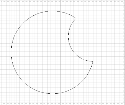

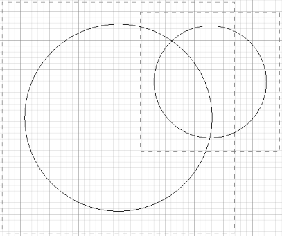

The subtract filter subtracts one input slice stack (subtrahend) from another input slice stack (minuend). The types of input are marked on their connection lines: + for minuend, – for subtrahend. The input stacks can be swapped using the Switch input for Subtract option in the context menu.
The input stacks should be free of self-intersections, otherwise the slices are joined according the positive fill rules. The output consists of closed contours which are not self-intersecting. Any hatching in the input data is ignored.
