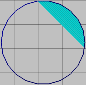

Fills contour area with parallel hatches
Consumes contours only.
Discards existing hatches.
