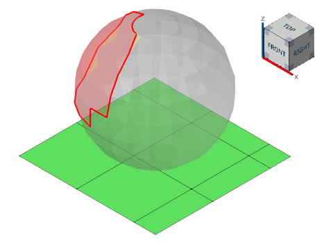

This sphere was assigned a custom direction for cluster detection in preparation for supporting it from the side
