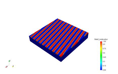

- Melt Indicator: This ParaView field will produce a binary color contour plot where any element which experiences a temperature greater than r1 has a value of 1 and any temperature less than or equal to r1 has a value of 0. This allows the user to investigate regions that may experience lack of fusion due to the chosen process parameters.

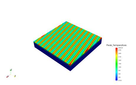

- Peak temperature: This field records the peak temperature during each time increment.

Peak temperatures
Melt indicator
