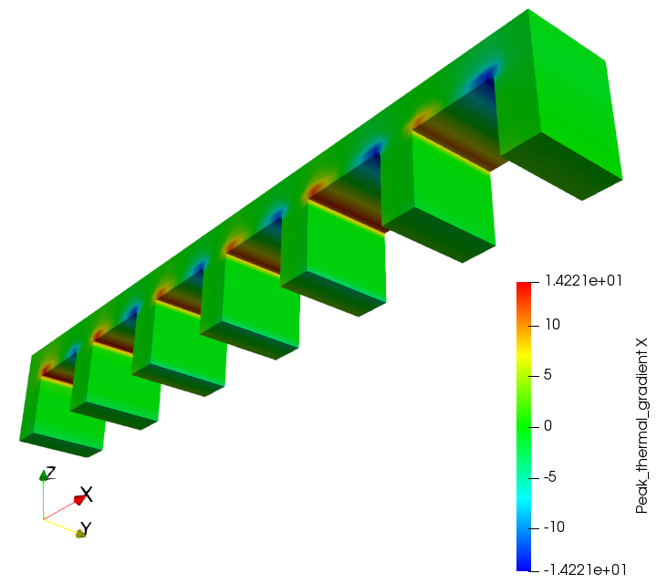

*ODTP: Peak thermal gradient result
Accumulates the maximum thermal gradient over all time steps
*ODTP
This card has no arguments.
Interlayer peak thermal gradient data along X in Kmm⁻¹, captured with *ODTP during part-scale simulation, visualized with ParaView. Due to the directional visualization, heat flowing towards the vertical studs either side of the plateaus produces a gradient pattern that alternates between positive and negative values.
