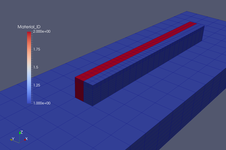

Include material ID in CASE file
*OMAT
This card has no parameters.
Including this card when using *LSRM for multi-material moving-source simulations makes the material ID available for visualization of the results. (Shown here with ParaView.)
Applies to 2026.0 Update and later
*OMAT
