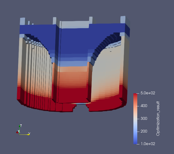

Watts laser power, calculated to achieve a desired interlayer temperature, visualized in ParaView

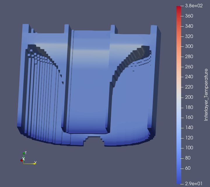

Simulated interlayer temperature, *TCTP card disabled

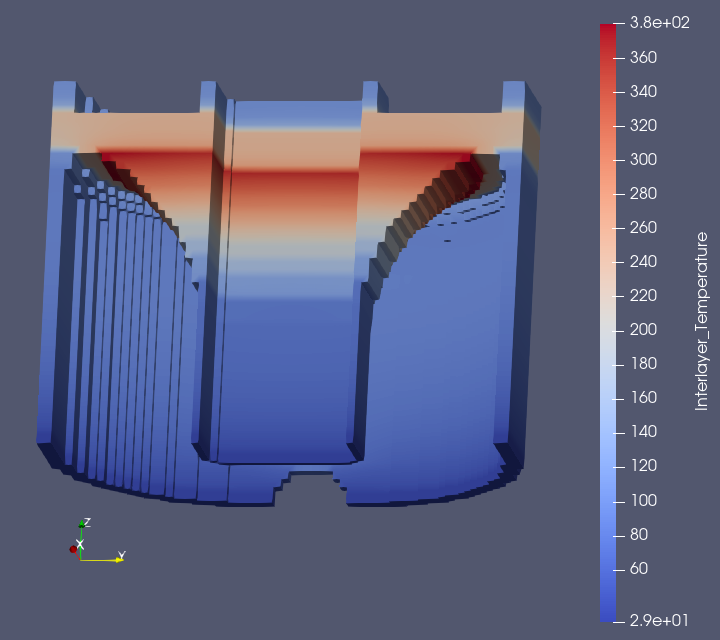

Simulated interlayer temperature, *TCTP card enabled. Temperature range to scale.
