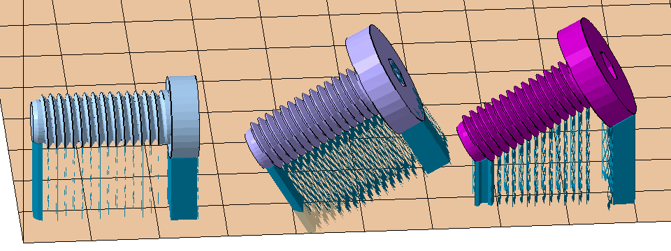

Starting on the default platform with a part that has support already generated and attached as parametric support (in blue),
- Modify your part as desired.
Example: Rotate the part.
- Keep the part selected, then, from the main menu, choose .
- In the context menu, select the List tab and click Replay support actions.
Three stages of rerunning support actions: Original, rotated and extruded part, reapplied supports.
