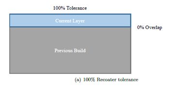

In Figure a, 0.040 mm is allocated for the fusion of the next layer, and there is 0.040 mm on top of the build, which results in a 100% recoater clearance.

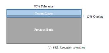

In Figure b, upward distortion of the previous build has taken up 0.006 mm or 15% of the powder thickness, which results in 85% of clearance remaining. This would be acceptable if your recoater tolerance was set to a value of 80%.

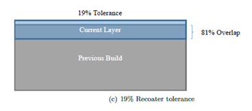

In Figure c, there is a 0.0321 mm build overlap, taking up 81% of the layer thickness. As a result, only 19% recoater clearance remains and the system issues a warning message, as the tolerance is well below the set threshold of 80%.

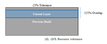

In Figure d, the build of 0.050 mm exceeds the entire recoater clearance of 0.040 mm for the current layer, so it returns a warning and a calculated interference of -25%. This level of upward distortion would almost certainly result in recoater blade damage.
