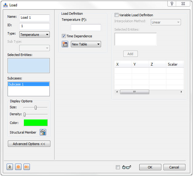

If Type is set to Temperature, then the dialog will look as shown below.
Temperatures are used in heat transfer analyses. Temperatures can be applied to bodies, surfaces, curves, and vertices. Temperatures can be time dependent only when a transient heat transfer analysis is selected. When attempting to add a temperature load to a structural analysis, a warning will be issued.
Temperature loads can have a variable load definition as well as custom display properties such as color, size, and density.
