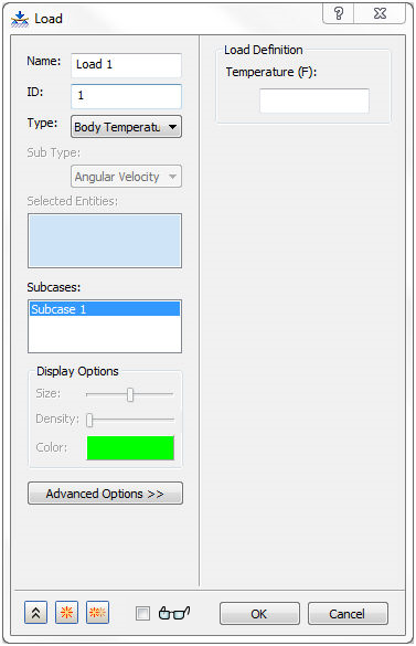

    If Type is set to Body Temperature, then the dialog will look as shown below.
    Body temperature applies a default temperature to the model. No entity selection is required. The default temperature is applied to any node and element that does not have a temperature applied.
    Example: An initial temperature condition could be applied, then create a body temperature of higher magnitude to create a uniform thermal expansion.
