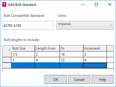

Add Bolt Standard Dialog Box
Creates a bolt mapping standard or adds a size and length range to an existing standard.
Bolt Compatible Standard
Specifies the name of a new bolt mapping standard. You can also specify the name of an existing standard to add new sizes and length ranges.
Units
Specifies metric or imperial units.
Length From
Specifies the lower end of the bolt length size range.
To
Specifies the upper end of the size range.
Increment
Sets the amount that the bolt length increases for each size created in the range. You can modify, add, or remove bolt lengths in the Bolt Length Mapping dialog box.
