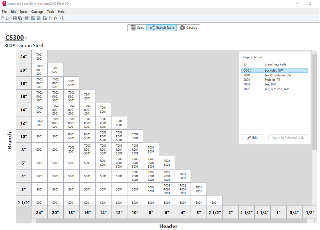

Branch Table Tab
Assigns branch fittings to use when connecting a branch in AutoCAD Plant 3D toolset.
The branch table is saved in the spec file with the spec sheet.
When you route pipe in an AutoCAD Plant 3D toolset model, branch table assignments in the pipe spec determine the fitting type and size to use.
Note: You can select multiple cells in the branch table. Press Shift to extend cell selection. Press Ctrl to select and clear a cell.
