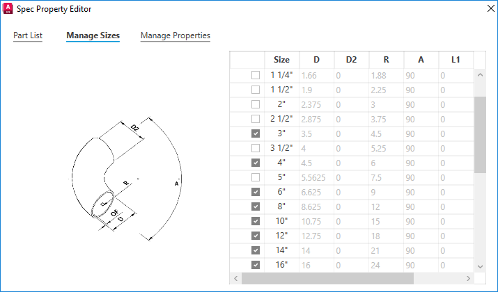

You can manage sizes for a specification in the Spec Property Editor dialog box under the Manage Sizes tab.
Use the checkboxes to select which sizes to include in the current specification.
Note: Size parameters cannot be edited in the table.
