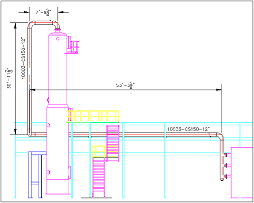

Orthographic drawings display two-dimensional views of piping, valves, equipment, and structural steel in Plant 3D models. The drawings can have annotations, dimensions, matchlines (plan view only), pipe gaps, and can show or hide lines and objects. Here is an example showing a single view.

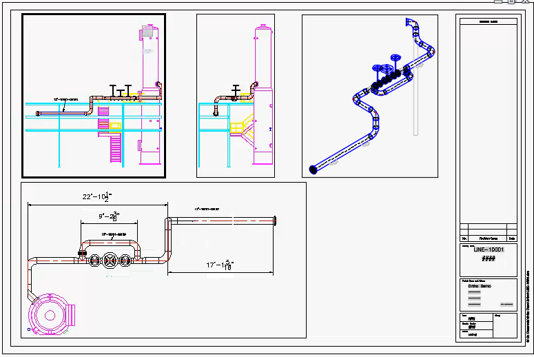

Here is an example showing multiple views in a single drawing.
