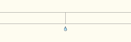

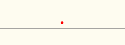

    To connect adjacent piping
    1. At the command prompt, enter plantconnectjoint.
    2. In the drawing area, select a part with an open port.
    3. Select a second part that has an open part at the same location.
      The disconnect glyph no longer displays.
