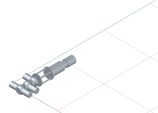

Place a Multi-Level Valve
Unlike other valves, multi-level valves are oriented as if laid flat on the ground as opposed to head-up.

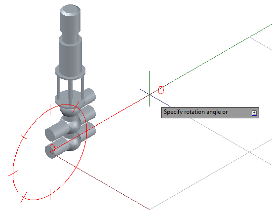

- Begin placing a valve.
- Press Ctrl to select a port. If possible, select a top-level port.
- In the drawing, specify an insertion point.
- Enter
p to set the rotation plane.
- Click to rotate and place the valve.
